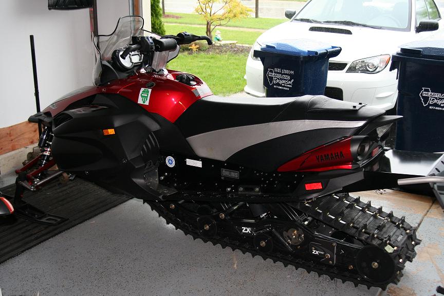

I have one on my apex. Would that work for you?
That is the only picture I have right now which is online.
http://www.ty4stroke.com/download.php?id=55228
Subaru2006

subaru2006 said:I have one on my apex. Would that work for you?
Subaru2006
Subaru:
That look sweet! Thanks for the pic. Looks really good.
You mentioned modifying the extension some for fittament...... What modifications did you have to make to the extension fit? Alter/cut the plastic from the machine at all? Cut down the aluminum at all from the extension?
Thanks much Subaru!
Mike

Well the normal instructions have you cut the plastic on the back of the sled. With the extension I notched out the inside corners of the extension because they sat right up against the muffler rubber mounts. I did this because I didn't want the extension to rub through the rubber mounts. So I basically rounded the corners out on the inside of the extension, I can post some pictures later if you want me to.
