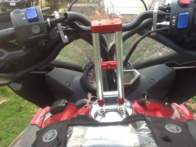

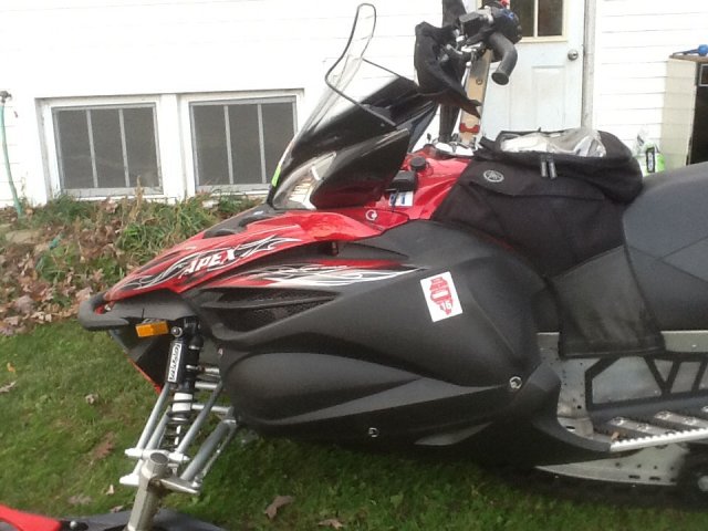

Vector or Apex, 2011 and up they are the same. 2" no issue at all. Taller than that you would need to reroute throttle cable and brake line and parking brake. I've been running my Attak and my 11 Apex at 5" over with stock everything. Yes, I did need to be creative in doing this. No issues in 10,00 + miles.
