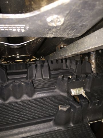

Hi I just recently purchased a 2003 rx1. I got it home and was going threw it and noticed that the track rubs the top of the tunnel. Just wondering if anyone has any advice that could help me with what is going on with this thanks for any advice!

that looks like the track was balloning on a long pull or the sled was bottomed very hard but my bet is on the 1st one. my 05 war has the same marks from the track balloning.

What can I do to prevent the track from rubbing?

more track tension

I think the track tension adjustment is inside a track window from rear .....I know my Attak was that way & I liked that better than the Apex xtx side adjusters.
