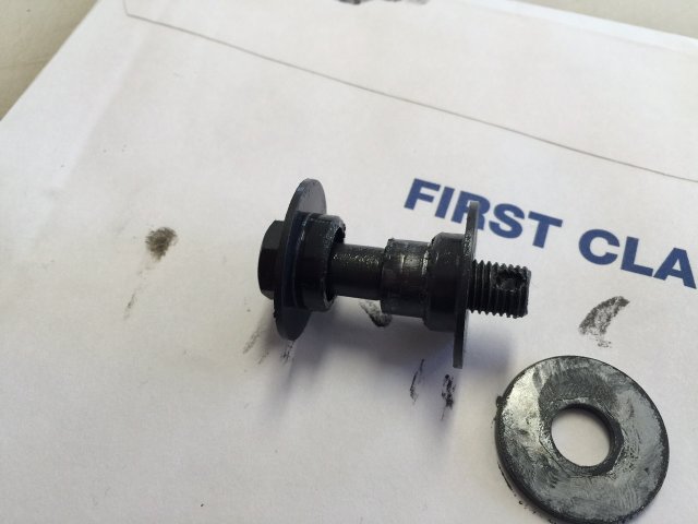

THESE LITTLE BASTURDS!
Does anyone make OILITE or something better than the stock plastic for these little bastards. I have tracked down the majority of my steering slop to #s 34 and 41 which connect the relay arm to the pivot arms conveniently located under the battery tray. Going to the dealer hoping they have them but would rather put something durable in there.
OH everything else is Oilite - a-arm bushings and OFT steering blocks.
