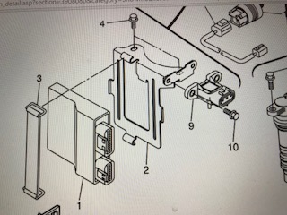

Found this. There is a pressure sensor mounted on the ECU bracket which looks like it should have a vac or air line going to it but it does not. Can anyone confirm it this nipple is supposed to be open or connected to something. Its part #9 in the fiche

Actually that is correct, open to air... It is the barometric sensor for atmospheric pressure. It is the same part number sensor as the MAP sensor.

DANG!!!! Though I had it. But saw no way anything would have got disconnected from it, nor was there anything hanging loose to connect to it.Actually that is correct, open to air... It is the barometric sensor for atmospheric pressure. It is the same part number sensor as the MAP sensor.
