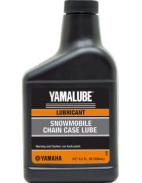

That same manual only lists one oil capacity amount of 8.5oz. Even though my two Apex's have reverse and using 8.5oz has the oil level above the REVERSE line, I still go with the 8.5oz; primarily because that is the amount of chain case oil Yamaha offers and it's already premeasured:

I filled it to 8.5 oz with 75-140 gear oil as i dont have reverse, with my side mount turbo i cannot get the full dip stick back in the case(without severe bending that makes it inaccurate)so i just have a plug on top.I think part of the confusion is that the chain case dipstick has markings on both sides, STD and REVERSE, and even the service manual shows this where one can clearly see the REVERSE line is much further towards the bottom of the dipstick which would indicate a lesser amount of oil for reverse than for standard models with no reverse:

I'm like maim and even though all of my Apex's and RX-1 have reverse, I still always use 8.5 ounces of chain case lube when refilling and never had an issue. Additionally, at least in my experience, using 8.5oz will put the chain case oil level right at that STD line on the dipstick so you shouldn't have to worry about being able to check it; at least not after filling it.
