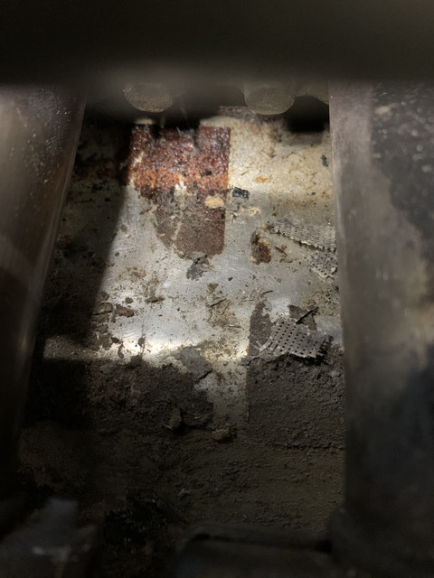

So what caught on fire? Oil that dribbled down onto the exhaust pipes at the head? Or the heat shielding? If it's soaked with oil, I would replace it. Mine fell off and replaced it with this stuff:
https://www.amazon.ca/gp/product/B016IMQDFY/ref=ppx_yo_dt_b_search_asin_title?ie=UTF8&psc=1
Used rivets with washers to supplement the adhesive.
the fabric on the bottom of the shield started on fire. As the sled warms up it seems to smoke more and more until POOF. FIRE. Just wondering if anyone else has has this issue.
Maybe I will just put some tin foil underneath the exhaust pipes /over the fabric to see if oil is leaking while it is running.
if it isn’t leaking oil from the exhaust maybe I will rip the fabric out as I don’t want another fire.

Let this be a warning to anyone else that accidentally spills oil down the back of the engine while filling it.
Part ordered from Amazon and no more fires. Is it me or does it seems like one issue after another lol.
(Knock on wood)
Also bought fire extinguishers on sale at Canadian tire for every level of the house and one in the kitchen/new batteries for the smoke detectors. The problem is you never think it’s going to happen to you :/

Why are you filling it through the valve cover? It's a dry sump system and is normally drained and filled at the oil tank.
when I bought the sled it had a low oil pressure code. I tried pressurizing the tank and blocked the hose while cranking. Didn’t work.
Then I poured oil down the fill hole in valve cover and hooked a suction device onto the outlet line on the oil pan pulling the oil through. Didn’t work.
Then I poured more oil down the oil fill hole in the valve cover and manually turning the clutch with outlet oil line unplugged trying to see if the oil pumped out. Didn’t work.
Took subframe off and oil pan and noticed the gear drive shaft was broken on the oil pump side.
At one point I wasn’t noticing the oil leaking down the back side while filling. Didn’t think it was to much. I was wrong and almost burnt my house down.
