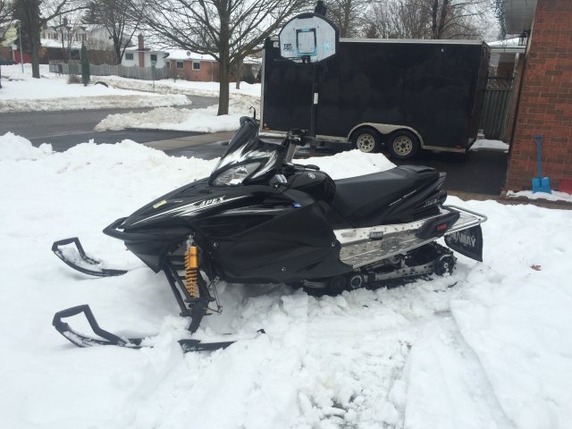

Just finishing up converting a new to me 2008 Apex to power steering with motec ecu. Still have to finalize the rpm signal from the motec to the power steering ecu, but that will hopefully be done this week. I'm really happy with the way the sled turned out!!

Fill us all in. How much cost. effort, time, parts, where involved? Oh ya, and extra weight?
machzrobbie
I had a complete 2011 sled that I stole the motor out of for my turbo sled so I took all the power steering stuff off it for this one, and parted out the rest of the stuff. I had to re wire the 2011 harness to make it work with the motec - removed exup and used the old style throttle bodies to get away from the electric idle motor. The claim is 18 HP with the Motec ECU natural aspirated @11,400 and I had Hurricane Dave port the head with his new porting which has shown good power so far this year - should make a good combination.

The power steering is kool, I'm more interested in the motec allowing you to spin up to 11,400. Daves claims are a peak power at 10300 on his stoker kit apex. Is your apex still stock bore and stroke? Is that 11,400 based on the limitations of the gear reduction ratio spinng the primary @9150. I'm curious as to changing the reduction ratio, as I've seen advertised, so 12,000 would turn out at 8350ish and by adding this extra reduction it should multiply the torque at the primary to allow more weight to be thrown at it for better belt grip and life. Then the motec could then be tuned for additional power? Thoughts?
machzrobbie
My motor is stock bore, stock stroke, 2012 head with the larger exhaust ports and the new style exhaust - I'm trying to take the best of everything and put it together!. I also adjusted cam timing to optimize higher rpm. The rev limiter on the motec is set at 11,800 with dyno results on the older motor with stock head porting making the most power at 11,400. I'm hoping to get this on a dyno sometime soon to see what it does - I'm hoping for around 185 hp. We ran the motec on a turbo sled last winter and on the asphalt this summer and it love's to spin high 11's with the supreme tool clutch and stock gear reduction.
