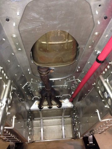

How hard is it to relocate the break light?
pay2play
Easy to relocate, remove the rear reflector and the light screws right in the same rivet holes. I added some length to the wires and ran the wiring under the tunnel through some pex tubing. It doesn't need to be that complex though, I was bored and did that early this fall.
pay2play
pay2play
I relocated also but used the grote light. Just so you know the light relocated on the back of the tunnel gets covered in snow dust and riders behind you will complain it's not visible. Plan on wiping it clean at each stop to give them some visibility to the relocated light.
Pic of mine is above
