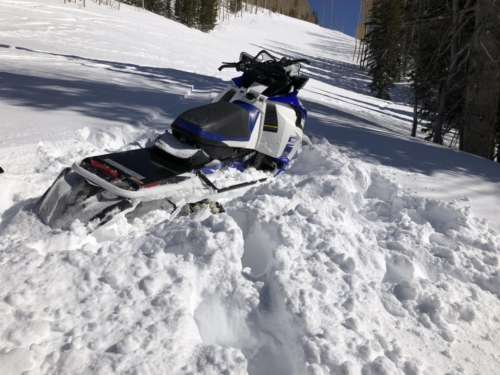

After spending two weeks between Jackson Hole and Togwotee and more than 11ft of snowfall for the month of January, the BTX proved it could run with true mountain sleds.
Obviously not with the same agility in the technical areas where the weight becomes too burdensome.
To the question this thread sought to address: will the Composit M67 2.62 lug work on the BTX?
Answer is most definitely yes! The M67 provided fantastic floatation when the POW was more than 5ft of fresh. In the meadows with rolling hills, trees and quite challenging chutes, the M67 never trenched.
In fact the only time the sled trenched was when I failed to take a proper line.
I never thought I would endorse a Russian manufactured product, but after more than 200 miles in the back-country at Togwotee this track most definitely proved it is a capable track that most definitely works on the BTX.
Excellent track and tremendous value when compared to the only other game in town for the BTX, the Camso Challenger Extreme. Without modifications, the Camso 2.8 lug will be too tall for the BTX tunnel.
