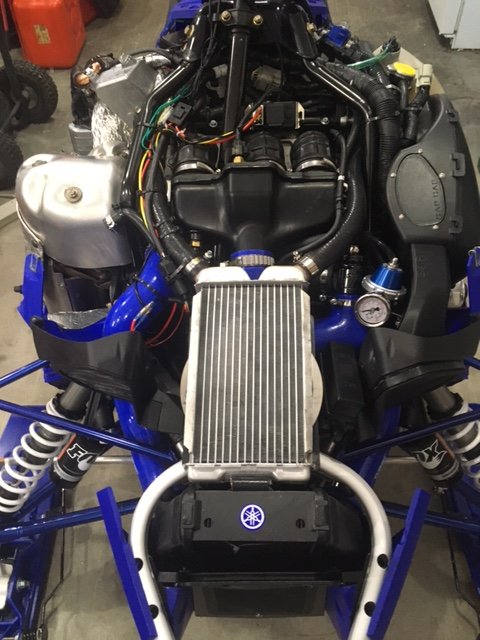

On my SW I have changed the impellor to the billet aluminum version from Dasa and I have also installed BOP's aux rad and fan kit.
I no longer have to worry about limp mode when waiting a long time to cross a road and or operating in low snow conditions.
Best thing I did to my '20 SRX, was the BOP auxiliary radiator and fan kit. My sled would definitely heat up rather quickly also. This rectified the issue. Never really have to utilize the fan, but it is a nice insurance just in case. I think the additional volume of fluid is also a big factor.
