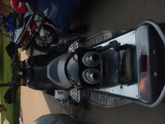

Just installed these new high quality bearings in my Yamaha spoked idler wheels. The old ones were shot after 2 years but the wheels were still good. Got them on ebay. They spin way easier than a new replacement dealer bearing at room temp. Put them both in the freezer and this bearing still spun really easy while the stock replacement spun super hard. Multiply this by the 9 in the suspension and I bet you would free up some hp at 100mph!!! They also make these bearings to fit the back axle wheels.
Just do a search of 6005 bearings and you will find them in listing. They are the premium ones with the blue seals.They are item 220360415727.
