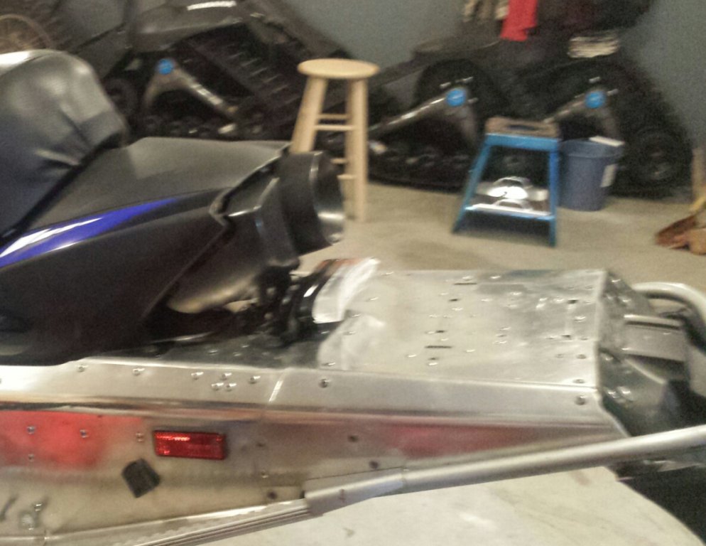

Finished jackshaft and driveshaft bearings. Disassembled entire skid to clean and regrease, and replaced all 11 wheel bearings. Polished tunnel. Relocated brake/tail light. Covered holes w aluminum. Sent 4 shocks out for revalve/rebuild for my 265 lbs.
Meanwhile...waiting for new STAR linkage, Hygear spring savers and a Hurricane Upgrade Kit. Thinking of the JRE spindles aswell.
Oil/filter and chaincase maint next and should be good to go....but for now, "Waiting for cookies..."
