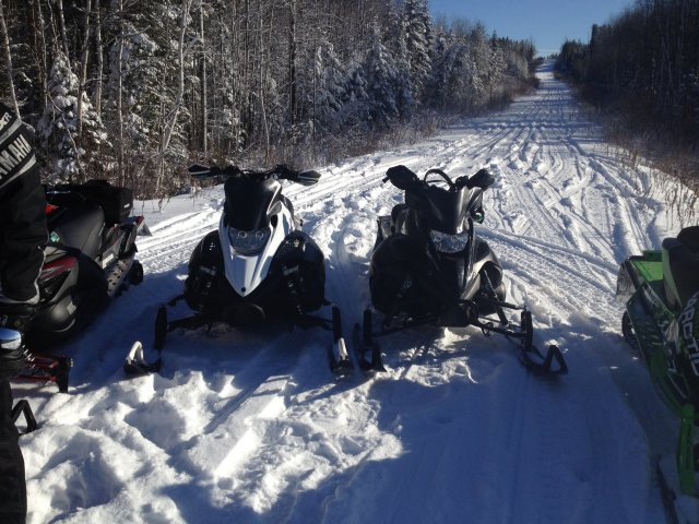

So, this summer I've added a couple new parts and finally got to take her out for the first ride of the season. I started off by adding a zbroz 43" wide kit with a set of exit shocks. I bought the kit used, but everything seems fine. I sent the shocks out to be rebuild and touched up the paint on the front end. I also added a new set of oillite bushings. (zbroz kits take 2008 oillites- just a heads up) - put a 120 miles on this weekend and boy or boy is she ever wide now. Good thing I don't trailer much, we had hard time fitting two newer sleds (2015 arctic ZR800RR) on a trailer (sled won't fit in the box of truck either- at least between the wheel wells). But out riding (in 8" of fresh power) the sled does sure handle nice. Little to no inside ski lift and easy to turn. I do play a little off trail and started doing more and more of it, so I might have bought the wrong kit
..... The only complaint I have- the spindle hits the arms at full turn. Will have a better idea on the handling and shock performance once the trails open.
I also added a the star 128" kit with a new ripsaw 2 track. I had some issues installing my new track. I had the track installed but ran out of adjustment. I ordered a 128 track but it was acutely 129. The rep from camoplast told the me the following "The correct length for a 128 inch track is 128.52 +/- .514 so the track could be 128 to 129 inches long and be in tolerance". So, I had to pull out the first track and get another new one installed. I had no problem returning the first track. The second track measured bang on 128.52"- I personally think +/- 1/2" on a snowmobile track is crazy, but what do I know. Sleds seems to ride real nice with kit install and handled the little stutter bumps pretty good. The track (not studded yet) seems to hook up really good, but we will see. I'm also running without transfer blocks. Robert from Star and Grizz were great help while I was trying to figure out what was wrong. Thanks again and Grizz is truly amazing and I owe him some beers for sure!
