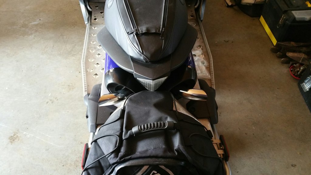

I bought those as well. Nice pieces. I had to cut them down and also cut the stock exhaust tips a bit to get them to sit squarely and look how I wanted. Only had to take the seat, plastics and exhaust end covers off. Left the rest on the sled. I tack welded mine on in 4 spots. Nice and solid. Only thing you cant do is put the inside bolt on the exhaust covers on as there is no way to tighten them (they are in a stupid location regardless IMO) and they can't be installed until the other plastics are on the sled. Hasn't been an issue for me. No issues with my Skinz bag anymore.

The discoloration on my bag was from the stock exhaust exist and is what prompted me to do the tips

Without seeing your winch setup, I can't make any guarantees, but I would think with the turn outs, you would be good to go. I'm pretty sure the deck area on the XTX is at least as big if not bigger than the one on your Attaks.
