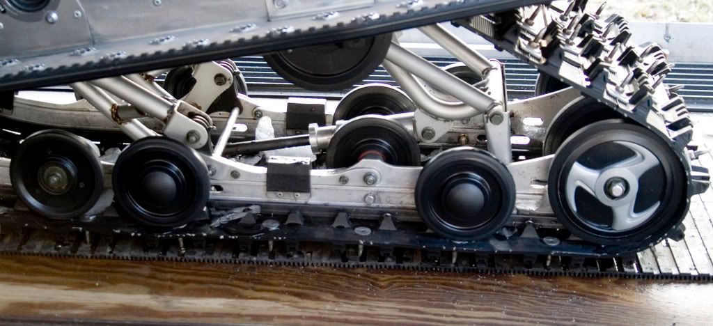

I just posted on another thread about this topic. I used the Doo wheels and mounting blocks and added an extra set of wheels in front of the large rear wheels. I also changed the hyfax to the narrow slides.
