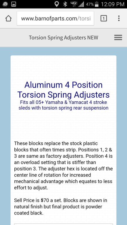

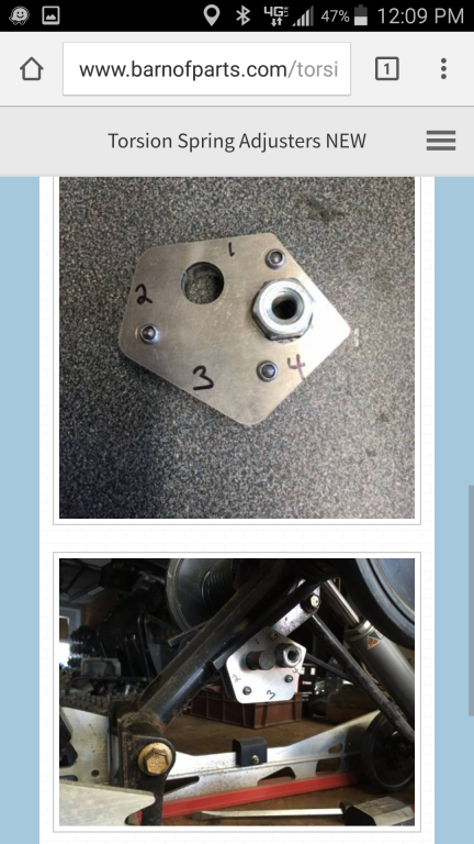

Star Suspension also sells the torsion spring adjusters as well . Aluminum block 5 position

I ordered a set of spring adjuster blocks for mine from Travis, and ordered new torsion springs from Jake at MacLeans in F'ton...but I know Barn of Parts have a used set of torsion springs he told me about...I think they were 160 USD.

Thanks for the information everyone. I am not sure if the aftermarket adjuster will work as it is too stiff when I set it on med or hard with the stock cam adjuster on the spring. For some reason there is very little resistance at the top, but as it compresses it becomes very stiff. It seems like the torsion spring is not opening up all the way. I am going to have the rear shock rebuilt, but I don't see how this will fix the sagging issue.
