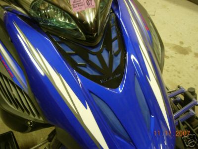

can you post a better pic of it?
kotapug
This is the best pic. I have for now. I had a guy make this one for me but only with the yellow prefilter. I could also of had it in stainless instead of black but I have a o7 rtx and its black so that is what I went with. When I receive it I will post diffrent pics. What are you looking for?

just to see it better, how does it work? does it bog when you take off?
adirondac blue
It is going to be lean .
SharkAttak
you might have to add some fuel to it down low

Do i need to make any adjustments to my sled? On a stock sled you do not need to adjust anything, just install the kit and go. If you have other modifications for instance an aftermarket exhaust then i recommend a fuel programmer

Looks good the only thing i see that may be a prob is the snow is gonna collect in the cut-outs where as what me and rockerdan have the prefilter is on the outside.....
kotapug
The pre filter I guess is between the airbox lid and the "fancy" cut out . So I hope that it does not collect snow. I dont ride in powder or really deep snow we are on trails most of the time so the little that I am in the powder I hope it wont be a prob. Do you guys think that I will need a programmer ?

That does look good.... And will work ... BUT - prefilter [must] be on outside /// fuel up 10 ///// you did a cool lookin job

Pretty cool looking...the fuel change is not neccessary but MAY help if you have any low end bog....i have added +20....and will be adding even more with my pc3/ign module next week.
but the ramair alone with no mods works well from all our testing.
as My bud Tom mentioned above,our prefilter material with my original design lays ontop so powder flies off....you may have some issue at times in powder,but groomed running you should be fine...looks kinda cool...
ours are alittle more stealth looking...i wanted mine to go unnoticed by cops and other sleds im running..lol.
ofcourse the SOUND is a dead giveaway!.....nice thing is you can keep OFF the throttle when approaching the cops,to keep them happy.lol
nice job
