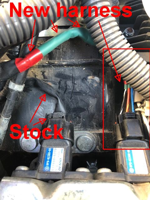

Going through this now.
Sensor on the Phazer airbox is the DENSO 5PS-82380-00. Had a broken wire inside the 3-way plug on the harness connector. Not enough slack to solder onto. tried to take it apart and repair this harness side plug but its a PITA. Sealed wire plugs and all that. doing more damage than good...
As for replacing the offending "Harness side" plug, I've researched it down to being a OEM Sumitomo Series: TS 090 Sealed Series
OEM P/N: 6189-0099. My connector has the number 10845 stamped on it.. seems to be a Toyota cross reference number to this part?!
Ordered this $3.57 connector kit that comes with new seals and connector ends: https://www.corsa-technic.com/item.php?item_id=774&category_id=157
Also ordered some 'color match' wires.
Will assemble / solder and seal it all together.

OK! My parts from Corsa Technic came in and it all worked perfectly. First, I mis-assembled a brand new connector, screwed it up twice since it was the first time ive ever done this.. the red wire pulled out once it was all assembled... Did not crimp it tight enough. I also did not crimp the rubber seal properly on the first blue wire.. I cannot figure out how to get these pins to release to rebuild/reassemble this...
Here is a video of 'proper' pin crimping.
I then assembled a brand new connector correctly! (ordered 3 since I knew one would be the training wheels)
Soldered it onto the Yammy end, sealed it using heat gun and shrink jackets. No more code! Running smooth and buttery.
