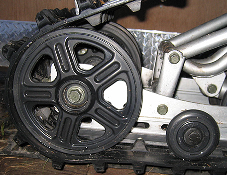

i only have the 3 rear spoked, their F-Cat wheels. thought it may help the "drag" feeling
