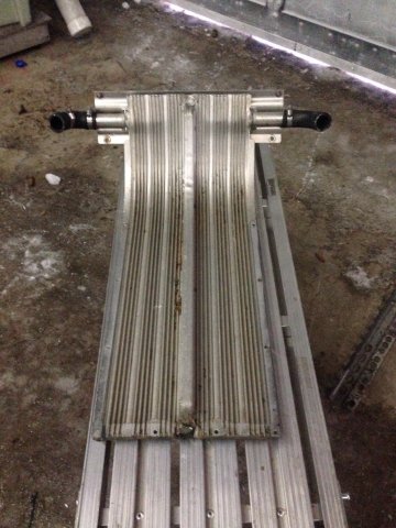

There's a site online called fabcraft and they sell piping In 6 foot lengths for that reason but I'm picking up an old firecat 700 body tomorrow and getting the rear cooler, tunnel braces and the running boards have a 3/4 inch pipe that coolant runs in and I'm using that to make my new boards with this setup. Similar to skinz airframes but my coolant will run in my running boards to my rear cooler.
That U style is perfect as a replacement. I wonder if it has problems with bottoming out. Looks expensive to get welded.
I'm starting to gather parts for my running board project and rear cooler, today I picked up the first important parts from a firecat 700, and I have no idea about the bottoming out question. Those pipes you see in the picture I uploaded will be the outside of my running boards, in which the coolant will flow through to the rear cooler. Will create a thread on this project when I get it all finish so you can see my work to get some idea for yourself

I'll be giving them a call here soon. I work at an aluminum extrusion factory and I sure as hell won't be happy with buying 6061 alloy aluminum. It is the dirtiest alloy we use and it always comes out looking like garbo. If you can find a place that makes 6063 aluminum then go for it. Find out what temper it is too. T5s aren't as hard as t6s.
