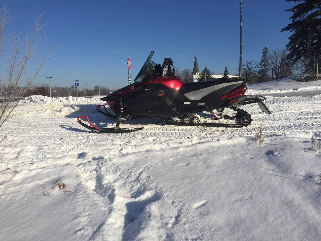

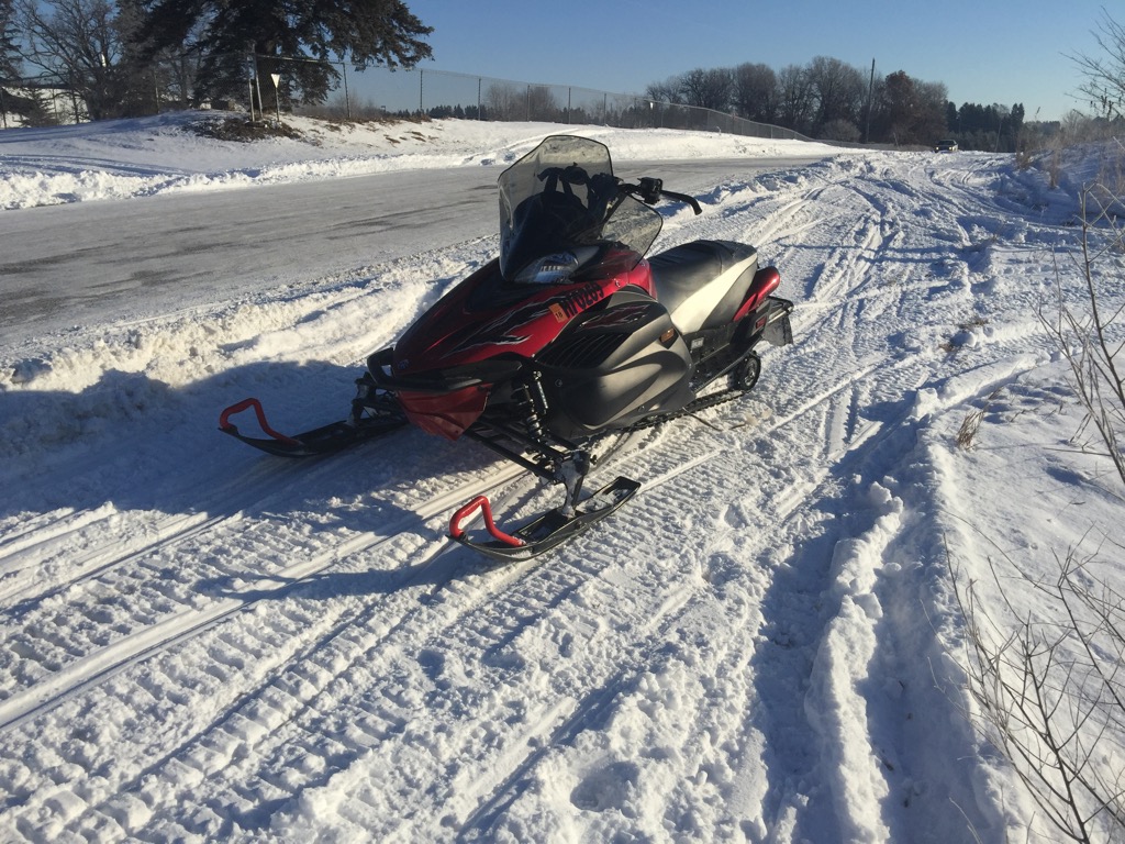

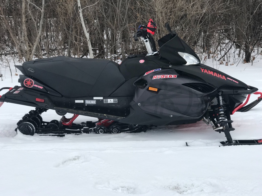

Put some love into this 07 Attak GT. Still not sure if this site saves me money or costs me money. Doesn’t mater either way because it’s all part of fun. Thanks for the help everyone. Here’s a couple pics. On a side note, it has triple points. Is it worth $200+ to swap them with snow trackers?
That looks great...nice job!
The higher seats on the Apexes improve both the appearance and ride characteristics by such a huge margine...it amazes me that Yamaha never did it from the factory themselves...IMO they would have sold a lot more of them.

Real nice..good to see folks who still love and re work the Attaks...

Nice ! ! What did you Paint the panels with ? I would keep the Triple points until they are worn. If you loosen the front shock springs all the way up so that your "A" arms are level it will improve your handling . When the Triple points are gone spend the extra 25$ and get he Snowtrackers . I have run both on my sleds and the trackers might be just a bit better.

Side panels are a custom vinyl wrap with tuning forks and GYTR randomly ghosted throughout. The tank , windshield, hood and shroud are a carbon fiber vinyl. I painted the tunnel and exhaust covers with an epoxy spray paint and used a matte clear coat.

Love the attack it looks deadly..nice job!!
