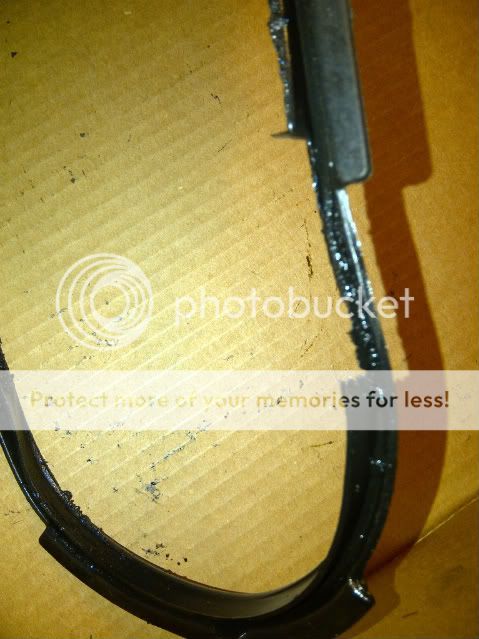

Two areas of concern,1 is on the case,you have a plate that is attached to the short shaft that moves slightly,it is the small shaft that holds a small bolt thru the cover,if that plate has a sharp edge where the chain rides,it will,over time wear,small slivers off your chain,and cause the slivers to cut into rubber seal,and cause leaking,and just plain damage to everything in there. Its hard to see but,if this is an 06 year sled,that was the year they had cover problems,not all of the covers cast,had enough room for the gasket to seat properly,and sometimes they would bunch up,and leak,or just not cover properly,take a good look there. good luck.wildbonz said:Some pictures;

Looks like I found the culprit, and looks like mnmsnowbeast is the winner!
Got a chance to look it all over a bit more closely today, and since you TY guys gave me the places to look I found this;
The rubber seal was damaged just like mnmsnowbeast predicted.

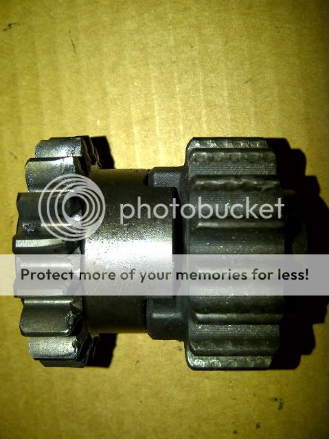

And here is a better look at the gears I'll be replacing. You can see the teeth marks in the one and the bends and shearing on the reverse gear that had been grinding a bit. The rest were still in great shape.
I hope that was the only problem in there. At least there is a reasonable explanation now. Just waiting on parts.
![Battleford-20110309-00116.jpg](/proxy.php?image=http%3A%2F%2Fi784.photobucket.com%2Falbums%2Fyy126%2Fwildbonz%2FBattleford-20110309-00116.jpg&hash=129ae68828b4446b340c3392c97e128b)
Thanks again everyone!

Wow,now that gasket really looks bad,man i am glad i could help,this is all stuff that has happened to my boys 06 rtx and my buds 06 gt and my 06 attak,this is what we were just looking for,when we did my track swap last thursday,hope all goes back togeather well,and yes sometimes alittle beer cant hurt lol...wildbonz said:Looks like I found the culprit, and looks like mnmsnowbeast is the winner!
