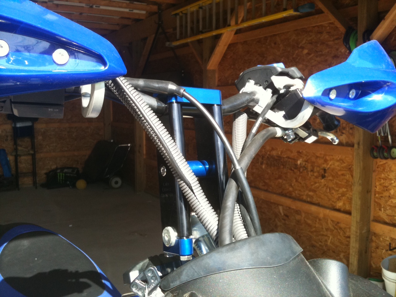

Roughly 2 inches. My riser is close and I had to play around with the throttle cable after I installed b/c i was getting some increased idel with the bars turned all the way. Once I loosened things up its been fine but I couldn't go any higher. Mine has the pivot block and the 2 inch riser on top. It's about a total of 2 inches higher the stock set up.
I put a pivot and 2" riser on. Like WNY PAT said with a little rerouting of the cables you will be fine. The pivot also adds an inch and a quarter too. But I don't need a cable extension yet.

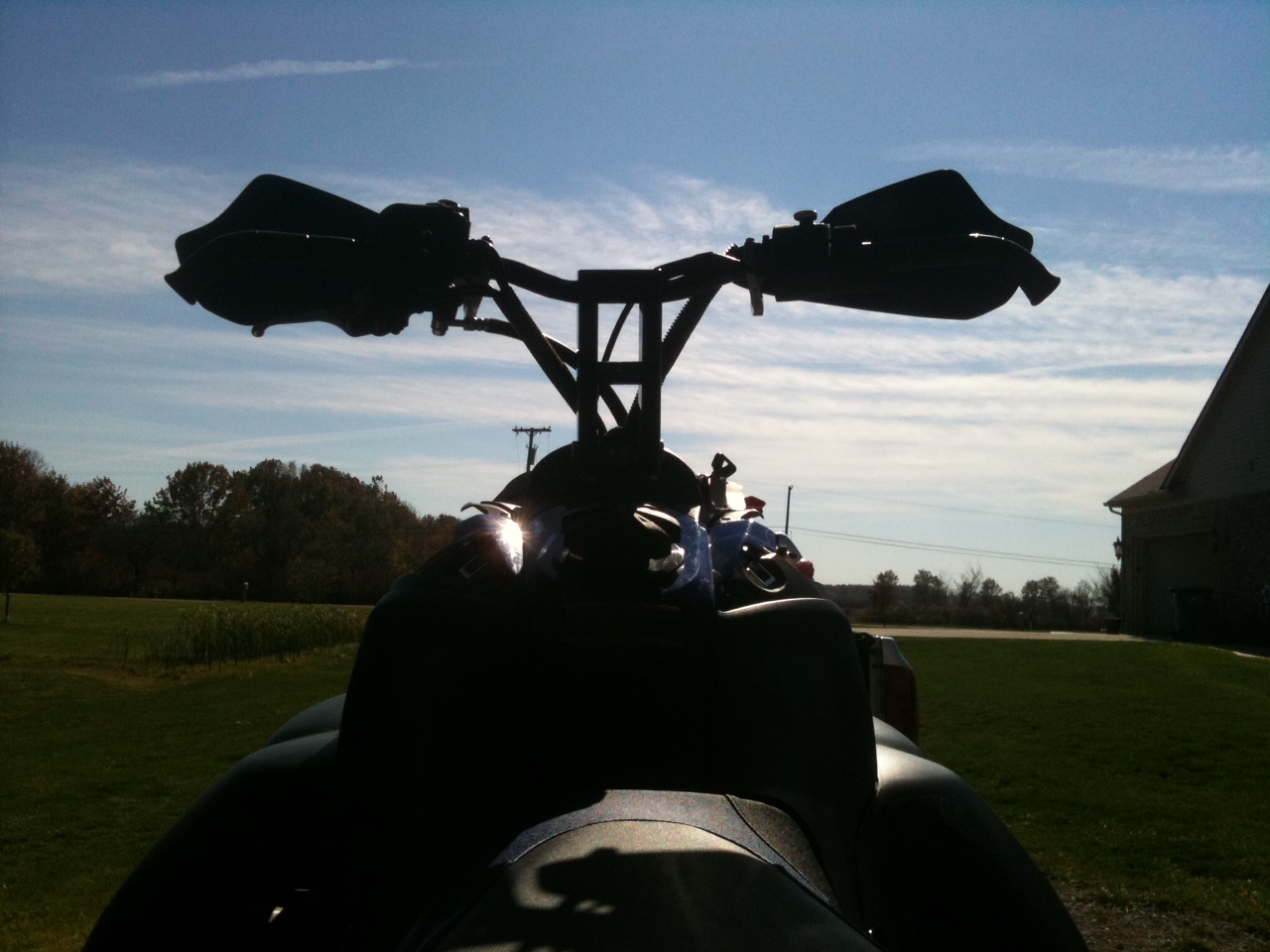

I have a 6in lakeeffect with the oft relocate and flat bars. I had to move the throttle cable under the bars but that was it. I also put the stock bars just to see if it would work and it did. full motion with no idle increase.
