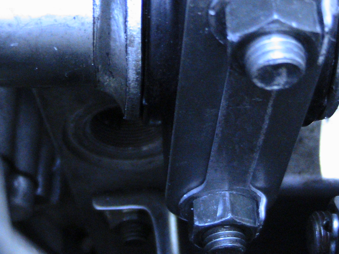

Hi guys, I just got my sled back from the dealer and finding some scary stuff. One of the engine mount bolts was so loose that, I think that the engine moved, hit the belt guard and tore up the belt. The other engine mount bolt appears to be missing. Can you please take a look and tell me if there is supposed to be a bolt in this hole?
Well, I found the bolt in the belly pan. My theory is that they torqued the mounts and were done, when I put a load on it the engine probably shifted and the bolts loosened. My guess is that you should probably load the drivetrain and re-torque the bolts a couple of times Thoughts? Are there other mount bolts that I should be checking?
