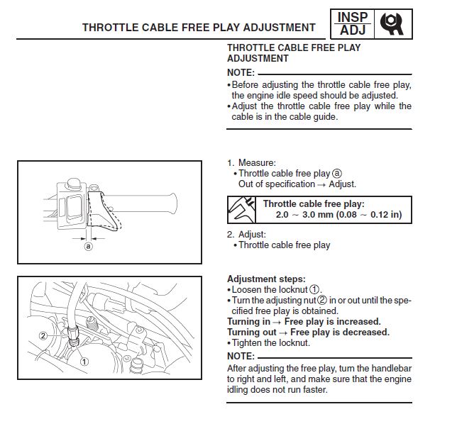

Have you checked for proper throttle cable free play? I suspect that it's a TORS issue where possibly the extension was not sufficient and is now slightly engaging the throttle (hence the high idle) and when giving it more throttle, TORS is kicking in. Although I only added a 4" riser on my RX-1 where I could only get the engine to idle higher when turning the handlebars to the extreme right and left, I opted to purchase the throttle cable for a RX-1M (Mountain version of RX-1) as they were longer than the ones used on the RX-1.
I had the cable installed in the handle incorrectly. I had the small C clip on it and it wouldnt seat correctly. removed it, reinstalled and if runs like a champ now.
