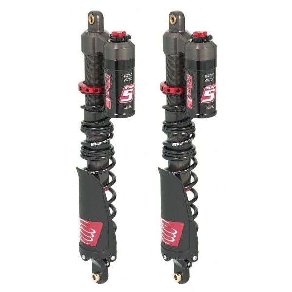

Looks like we will be running Elka Stage 5 shocks all around for the race! Thanks to Elka for coming onboard as a sponsor!
We have started to update our facebook page recently too. I will try my best to keep this thread updated on the sled builds, but follow our FB page for all other updates with the race, and preparation. https://www.facebook.com/CainsQuest2014Team82
