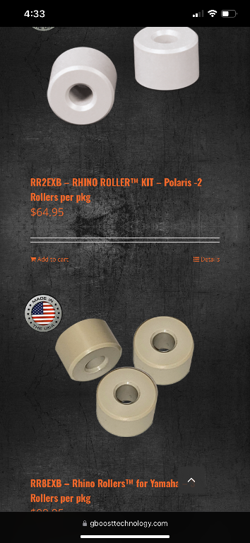

I didn't know Gboost had their own rollers? Has anyone tried these? Do they effect RPM the way the Hi-Torque do?Maybe Gboost rollers

It's still up in the air if these are actually Gboost rollers. I had never heard of those before. If I am not convinced that I know for sure whose rollers these are, they will likely go in the trash.I didn't know Gboost had their own rollers? Has anyone tried these? Do they effect RPM the way the Hi-Torque do?

Does it match any of the pictures?
They might be Hauck rollers... as sideshowBob had mentioned. I have emailed Hauck Powersports the pic to see what they say.

SOLVED!
Hauck Powersports replied to my email and said that they look like their rollers and that they have since started making them with shoulders so that the washers aren't needed. I guess I will just hang onto them for spares. I have been running Thunder Products rollers and have 2 sets of those in the drawer as well.
