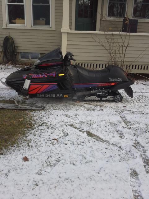

DGZRT
- Feb 23, 2006
- 1,181
- 486
- Stevens Point Wisconsin
Nice Sled ! A guy we use to ride with had a Vmax4 all I ever saw was his Tail lights LOL ! He never did let anyone ride it.
