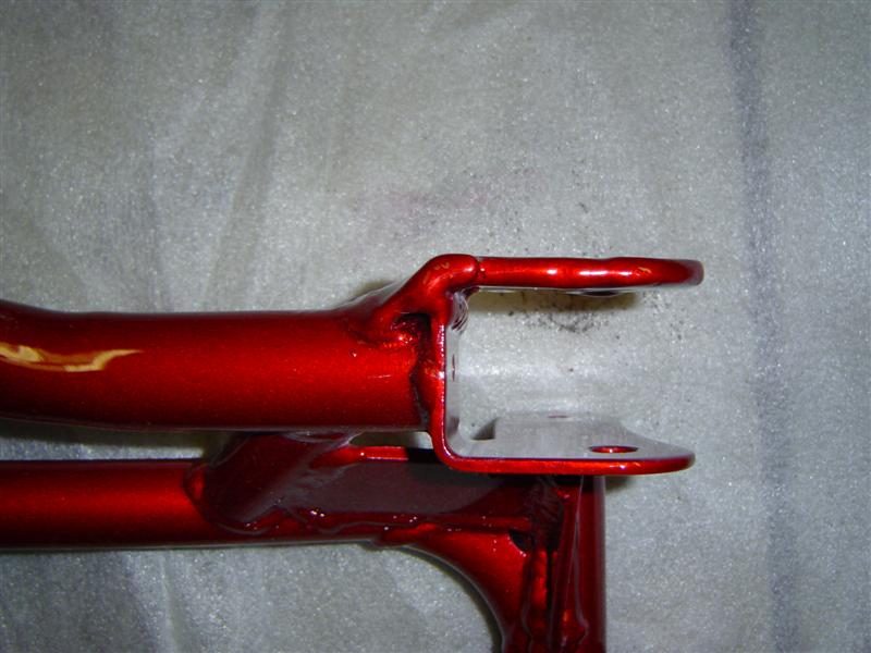

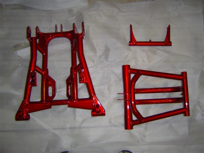

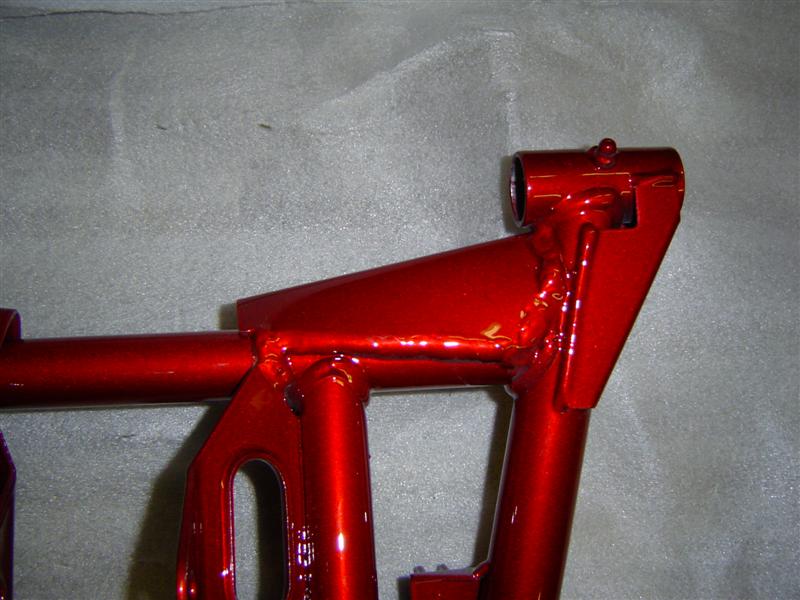

Dad's 06 Vector received an overhaul of sorts this fall.
Ice ripper XT
Rebuild front shocks
Rebuild/re-valve Mono shock (to remove the spinetinglers)
Pioneer performance Mono bushing kit
Fourth wheel kit
Chain case, speedo and secondary bearings
Exhaust donuts
Pioneer bulkhead and A-arm bushings
SledStart HID headlights
Reinforced front mono arm
Powder coated Front and rear arms candy red
Fixed snow flap mount
Random front plastic to repair damage from a roll over incident out on a lake last year.
