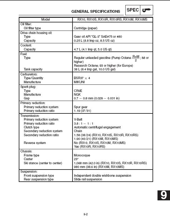

I just read on the FAQ section on chain case oil change that all four strokes with reverse only need 4 oz. of fluid?
I drained mine last night and what came out looked less than 8.5 oz. and closer to 4 oz. I was wondering if anyone could tell me if 4 oz. was true and why?

Just download the pdf service manual from this site and you have all the info you ever need to service that machine......

Look on your belt guard. It is printed there along with other specs. 8.5 oz is the correct amount.

Another Phase said:Look on your belt guard. It is printed there along with other specs. 8.5 oz is the correct amount.
Bingo...

Why does the dip stick say if you have reverse put 4.5 oz ?

That is mainly why I asked this question. I don't see what it would hurt to have 8.5 oz in there.
I will probably go with the 8.5 oz. level.

I put 8 !

I just changed mine. The dipstick has two marks on it. The "rev" mark is much lower, but it took 8oz to get up to that mark.

I have just put 8 in there, it works fine AND you can say well you know I have to much chain / gear lube in there other wise I would be faster. LOL
No seriously I have like many others just put in the 8 and run for over 20k miles, never a chain or gear issue.

BINGO! thats the 1, have a measuring cup handy to refil it w/250ml or 8.5oz. and you're all set, I change mine every 1000 miles or so only takes 10 min. and will prolong the life of your chaincase big time! also check your chain tension adjustment it explains how to adjust in your owners manual.
