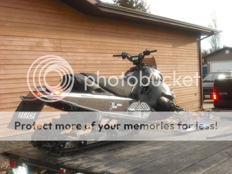

Here is my RSI set up. I have the adaptor plate, 2 inch riser, back country bars. All said and done it is 2.5" higher than stock and I never had to add any cable extentions.

billy2guns that's where I got the idea when I saw you sled in another post. Looks like a cool set up. Do you notice a big difference over stok?
billy2guns
NLViper said:billy2guns that's where I got the idea when I saw you sled in another post. Looks like a cool set up. Do you notice a big difference over stok?
Well I personaly didn't like the look of the stock XTX bars and they were a little low for me. The whole job of replacing the bars was fairly easy. I did not bother re-using my old grips. I went with RSI's heater elements and there grips. All the Yamaha brake and throtle assembly split in two pieces so you can add them after your bars are installed and where you like them. If you email the guy's at RSI and tell them what you would like to see all said and done, they will sugest everything you need to get the job done.
