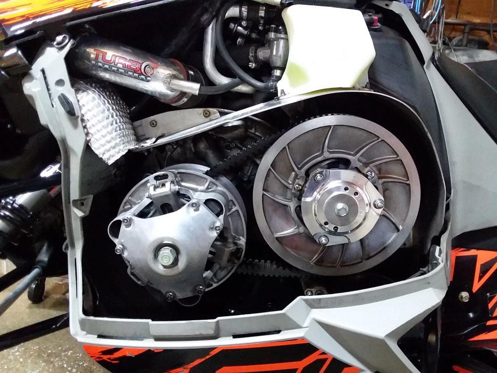

This stuff is pretty good.What about cleaning the belt dust off the plastics? I’ve used spray nine which works ok, anyone have a better cleaner?

I use Castrol Superclean, purple bottle buy it at Wallmart. I remove panel, spray everything, rinse off, fire up the air compressor blow water out of clutches and looks new again. Did it this evening, took 5 mins. I also spray on side panels and scrub with brush where exhaust/clutch dust blacken them. Works great.

Trails just about everywhere are MINT this season. I have not seen our local trails look so big and wide since '14. Having over 34inches on my snow stick depth, really makes for best trails ever!I’m going to switch to the ultimax next year. I just put a new 8jp on for my trip north and I have so much belt dust it’s embarrassing lol. I do use acetone on the sheaves.

I bring my white panels inside house, and use a magic eraser with warm water, It rubs off the plastics super clean.What about cleaning the belt dust off the plastics? I’ve used spray nine which works ok, anyone have a better cleaner?
Much of it is brake dust, and bottom edge gets dirty from my leggins.

Lowered offset, stock 21/41 gears also come into play for less dust, but the Ultimax is a very clean belt.
8DN is NOT the correct length belt, you will need more gear or else you lose mph.
8DN is far cheaper for sure though, I keep as spare.

I went to the Gates Carbon Fiber equivalent belt this year. WOW, so much better on grip and very little dust. The OEM 8JP is a mess...

A couple times each year I'll pop my clutches off and drop them off at a transmission shop for a few hours. They put them in their hot pressure washer for a few hours, and I slide the guy a few $ when I pick them up. They come out looking (almost) brand new. After this, it is scotch brite to the sheaves, then acetone for a final wipe.

Hot soapy sunlight, to clean clutches, then lacquer thinner to belt contact surfaces
Pstn head
Spray nine on manic eraser, works pretty good.

Me Brake cleaner for alum surfaces only .. don't trust it on rubber or plastic parts . I had a clutch seize up long ago and have only used hot soap and water since. Spray 8 used to work good but the new spray9 is way better
