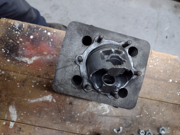

Sounds like a spring project as I currently don't heat my shop. Did have to repair
the VK a few years after i bought it .. Always ran well but wouldn't idle on two cyl.
Often set track in the dark so never investigated it . Turns out the previous owner
must have used starting aid and had blown crank seal apart(found the spring)
and the plug over the injection wasn't even in the sled . Spark plug was packed with
Almn. Currently has a mid 80's SR540 core and the flywheel , ign and carb from
orig 93 VK. The ign side made melted the seal but still in place.
I had used for a couple years this way.
Also understand why you used them in Labrador and North as it never stopped.
