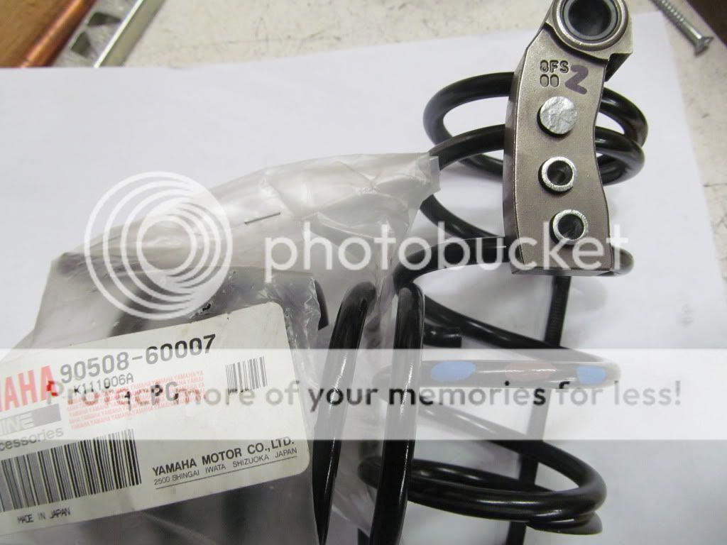

Here's what I had for my '11 Nytro.....called the Sea Level Kit from Yamaha for the MTX which is supposed to be for 0 to 1000m..
Gearing is 22/40, secondary helix is stock, and the springs and weights can be seen in the picture below. Arms are 8FS.
Worked really well for me last year, but after the engine mods, I went to Ulmer's stage 1, which is an exellent match to the engine power.
Also, the 21/39 is only a 2% difference over the 22/40 so the XTX stockers should also work with this setup.
