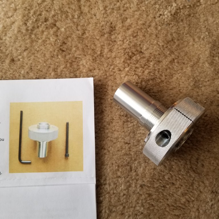

But you need to have your belt deflection correct, no matter which belt you go with. An aftermarket belt adjuster works perfect in this situation. 1 quick turn and you are done. Don't even have to take off the clutch and you can turn it with your gloves on.
