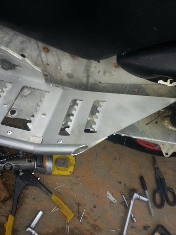

So I was sick of the narrow boards on my rx1 I have huge feet size 15 and my dam feet always hit the lip on the boards when I pulled my legs back so I bought phazer wrp boardsand fabed the tunnel on the rx1 to fit cut the lip back one inch the whole lenght and pulled it out sliped the board under the foot wellriveted everything in place angeld the lip so it fit nice I still need to move my heat exchanger s to under the tunnel and cut all the opeopenings out and weld shut my 2 seams on each side and rivet some angle on to support the tapper just standing on them omg what a difference let u guys know how much after tomorrow s ride the boards are now the width of the foot well for 26 inchs nice and wide hers some pics

Wow that looks really nice !! Yamaha should've made it that way to start with.

Thanks once I get it all done should look realy good and shouldnt have a issue with snow evacuation anymore either iam pleased how they are turning out

Did other side a bit diffrent ripping left side apart to match right and I think iam gonna leave the heat exchangers the boards dont look bad at all

Rode today threw some some pretty rough stuff and I love the boards felt more under control cause my feet wernt half off and they didnt move a bit very happy with the mod

Yeah it looks like it came out great. It doesn't seem like too bad of a project to do either. I would've never thought to mount running boards made for a Phazer on a RX 1.
