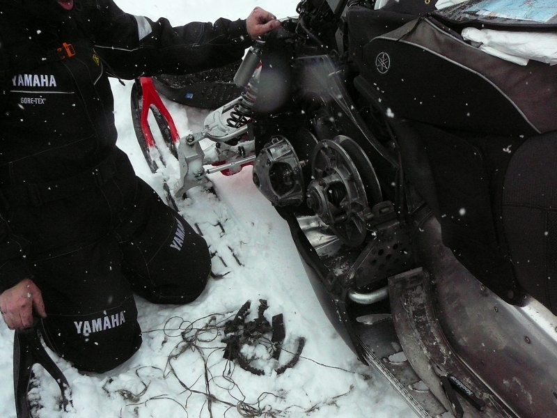

I have always used OEM belts and average 5000-6000 km per belt. My last belt lasted about 1500km but i had buried my sled while carving in 4 ft of powder and got caught under an ice crust. Smoked the belt trying to get it out. Afterwards i could feel a slight vibration. I should have changed it as the next day it grenaded. It took almost 1/2 hour to get all the cords and belts pieces cleaned out of the clutches.
If you smoke a flat spot on your belt, changed it out.
Ditto to that photo. Did that one spring day in the mountains while going hard on a lake with overflow. Went from 50 kph- zero instantly. Almost broke my feet on the footbars so removed them (the footbars, not my feet)
