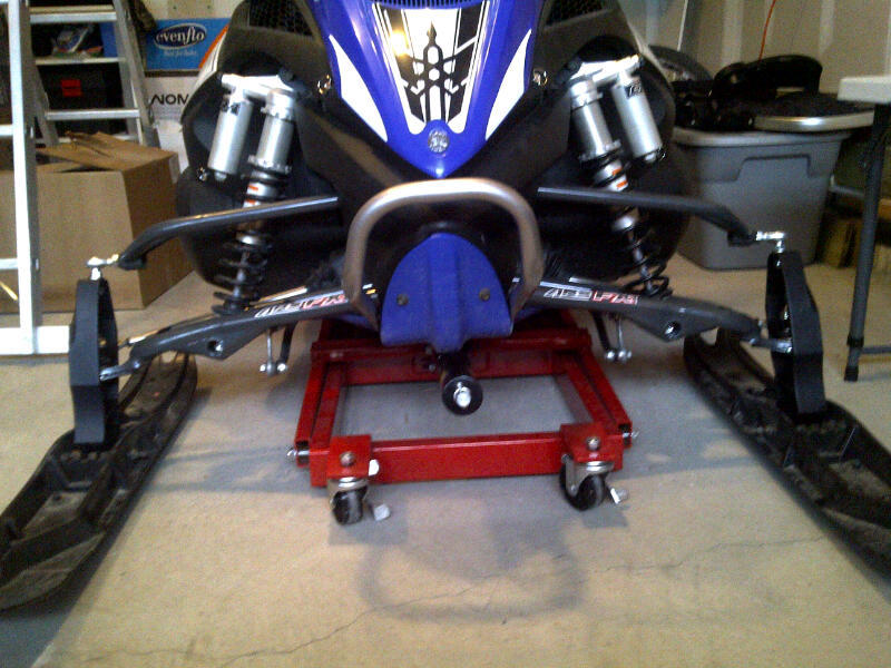

I had the exact same damage- all joints toast and damage to both spindles. I started to make the parts list and add up costs and decided my money would be better spent with a new front end.
I went with zbros 43 + 1, looks awesome but not enough snow to get a ride in..
