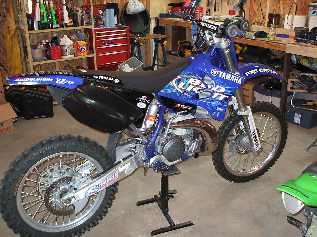

yes i have a 2004 yfz with a 471 stroker kit with 13.5:1 use race gas other wise u will burn a hole in ur piston plus the extra power is amazing i can run with a rm250 bored to a 282 which is making 60-65 hp so definetly run race gas
