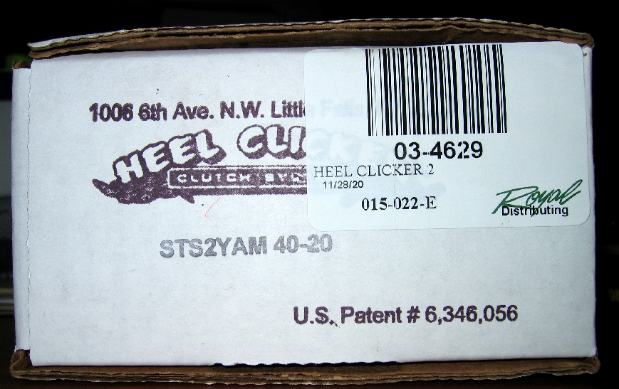

It seems odd that the Heel Clickers I just received a week or so ago do not look like the ones that the Royal distributing catalog show. I even looked at last years catalog and it’s the same as the 06…
On the ones I received, there is more like a rivet deal that attaches the shoulder to the main part of the weight and the shoulder is black not silver like the catalog. Also mine do not have that small little hole or second step at the top part of the shoulder near where you would add weight…..In the catalog there is either a torx or Allen bolt holding the shoulder on….
I have tried calling the only support number I can find, its 1-320-632-4749 and nobody answers and I can’t even leave a message….
Anyways, does anyone have a picture of the previous HC that were called Hammer times…I have a funny feeling that is what was in the box…I hope I’m wrong….Below is a scan of the box mine came in which seems to say they are HC 2….and also a pic from the Royal catalog…..
Pics please if someone has...JD

JD; you have the newest recent updated HC,s. They have a bushing between the rivet & weight for added reliability. Those are the good ones(all black)
