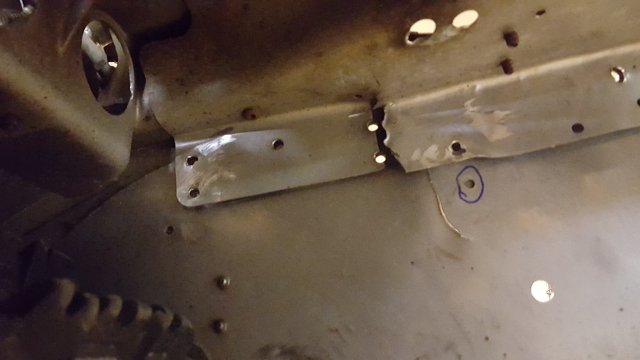

All of the 8 rivets holding the flimsy upper tunnel piece to the bulkhead under the gas tank were either loose or worn all the way through the thin upper tunnel piece. I drilled a few of the rivets at the vertical tunnel to bulkhead junctions on both the left and right side and didn't find anything suspicious at all. It doesn't make sense to me how the rivets holding the vertical rivets pieces together (which would be where the most force should be due to the constant up and down shearing action) wouldn't wear out first.
When I begin to secure the upper part of the tunnel back to the bulkhead, I am assuming there should not be any gap between them, correct? Before I started digging into this, there was about a 1/8" gap between the tunnel and bulkhead... that isn't normal, right?
I would think no, its not normal, but i am having a hard time remembering exactly how mine was. That area might be doubled up with layers of metal.cant remember.
Its also possible the metal has burrs between them not allowing them to close up tight
I fixed mine a year or 2 ago
I could not get rivets to pull some of the areas together. The holes were so worn i had to use 1/4-20 button head screws with fender washers and poly locknuts and loctite
Dont just look at the top of the tunnel.
Look at the sides where the tunnel meets the bulkhead, make sure all rivets are good and tight.
If possible put set of pliers on the back side and gently try to turn them.
Any movement at all should be replaced.

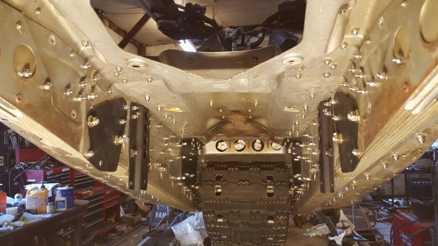

If your tunnel is getting loose where it attaches to the bulkhead, it could crack the tunnel like my Warrior did.I patched that up, but several rivet holes were egged out. I replaced almost every rivet from the snow flap to the drive with stainless bolts.

If your tunnel is getting loose where it attaches to the bulkhead, it could crack the tunnel like my Warrior did.I patched that up, but several rivet holes were egged out. I replaced almost every rivet from the snow flap to the drive axle with stainless bolts.
View attachment 123580 View attachment 123581 View attachment 123582
that's what I saw with mine as well.
running down the sides of the bulkhead all the rivets were loose.
just looking at the sled it all looked fine but once you start digging you find more and more problems, lol
