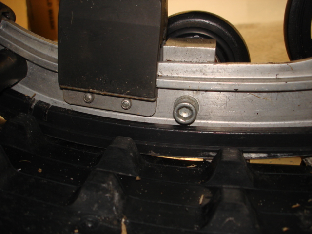

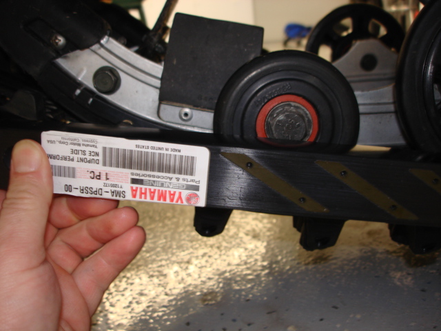

Force4000 said:actionjack said:I think it sounds like your track is too tight. But how 'bout adding wheels at the wear point. Also, how close are they to 10mm? Mine is a 07 with a 136 mono but I have the cheap sliders and have 1500 miles on them and I have at least 13mm everywhere.
Well ive considered the wheel kit here:
http://www.ebay.com/itm/Yamaha-snowmobi ... c2&vxp=mtr
Even shows a picture of the wheel being installed where all my hyfax wear out completely. I am at work now so I cant look at the hyfax to measure the wear but when I get home I will. It has to be around 11-12mm tho after just a weekend of riding :/
Do I need to drill a hole in my slides though to mount that wheel kit? I didnt see any pre-drilled holes around the area I would need to install them. Thats my only concern.
I have this exact same marginal snow wheel kit on my '07 Apex. It is designed to be installed at the front curve in the slide rails where you are wearing out your slides. I installed these wheels when my sled was a year old and I was replacing my worn out slides for the first time. They did completely eliminate slider wear in this area. I have attached pictures of the front and rear view of the installation. Yes, you need to drill holes in your slide rail to install them.
Some words of caution: Use red Loctite on the bolts. I used blue Loctite initially and I lost a wheel when the bolt backed out. After re-installing the bolts with red Loctite I have not lost a wheel since. Check the replaceable bearings every season. These small wheels spin at a much higher RPM than the larger wheels and consequently the bearings will fail sooner. I usually end up replacing the bearing on at least one of them every season.
The Dupont slides probably will negate the need for these wheels. I am just getting ready to install my first set of Dupont slides and I will be leaving the wheels on since they are already mounted. You can see in the last picture that the Dupont inserts start right about where the wheel is mounted. You may want to try the Dupont slides by themselves first and perhaps save some time & money by not having to install and maintain the extra wheels.
