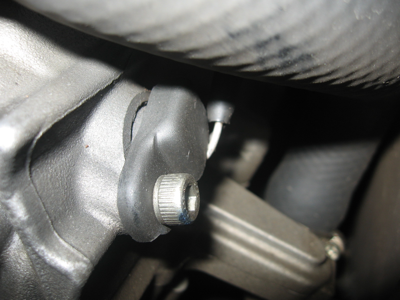

Here's what I found on mine. In the first Pic, I believe the wires should have been positioned behind the protective plate not around the side and a small zip-tie would help as well and possibly some teflon wrap to prevent chaffing (used when i turned wrenched on F-16s back in the day). The second pic is with the cover removed, note the opening in the insulation. It was not that apparent until i moved the wire and noticed a hairline in the insulation. When i probed with a sml screwdriver, it came right open. The bare wires were probably not contacting the plate directly, but due to the split in the insulation, it would be prone to arc under a load.
