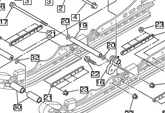

Found this last night going through the skid. This is the bolt that goes from rail to rail near the bottom of the front torque arm. Went to loosen it and found the bolt sheared off inside the small shaft/spacer (about 1" from head of bolt). Ever seen this before? If not, something for others to look for.
It is part #17 on the Fiche in "Track Suspension 2" diagram.

i would take a real close look at the support bracket and the rail where that bolt goes through.
you might find the rail is cracked.

You may have over torque it. But I would look at the rail it maybe bent.

I would be very surprised if rails are bent, looks like the hulk got ahold of it and over tightened

I dont think it is over-torquing. I pull the skid every year and go through every nut, bolt and bushing one-by one. When I reassemble, everything gets torqued to factory spec as per the service manual, I am pretty fanatic about having everything properly torqued. Rails are neither cracked or bent and front torque arm bracket that is mounted on the rail is also fine.
Looking closer at the spacer that bolt runs through (spacer mounts between the rails), it is flared/bulging on one end, so something happened at one point in time while riding. I will just add this to the checklist of the many parts I have broke in the Mono.
