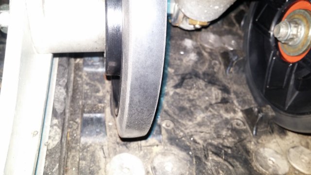

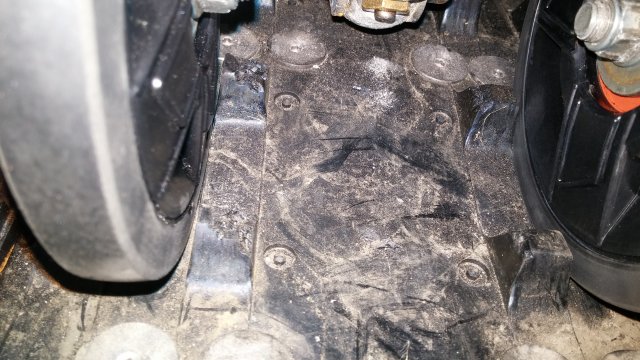

Just installed the excell 6 wheel kit on my FX Nytro. It seems the the front wheels that go to the inside by the front shock anrt centard and rubbing the inside drive lug??. Anyone else have this issue??? Thanks guys

Did you try putting the wheel on in the opposite direction in case its offset more in one direction than the other? Mine are all so the big X is showing toward me when I look at the skid from the side

I tried them both ways and they seemed the same.. I didn't think there was that much of a difference in the offsetDid you try putting the wheel on in the opposite direction in case its offset more in one direction than the other? Mine are all so the big X is showing toward me when I look at the skid from the side

Can you snap some pics of the issue?

I can later. But the problem seems to be the outside of the wheel is rubbing the drive lug. And there seems to be a lot more gap on the rear of the wheel

Maybe I need to flip them

Check the mounting bracket. When I tightened mine down the bracket moved just enough to where it wasnt sitting on the rail right . Flat/straight edge on the groove of the skid .

I thought they were I'll checkCheck the mounting bracket. When I tightened mine down the bracket moved just enough to where it wasnt sitting on the rail right . Flat/straight edge on the groove of the skid .

I run mine with the X face toward the rail. Its worth a try to turn them around. Lots of room between the rail and wheel so hopefully flipping them pulls them toward the rail ad away from the drive lug
