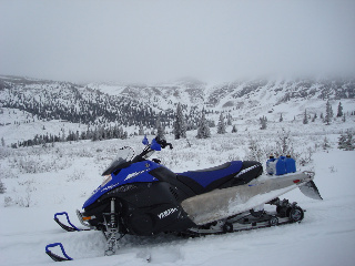

Here is what i did for extra gas for my mtx. I bought this kit online from mountainadiction. Its a rail system cans slide on and off with ease and stay on!! no bungies in the eye!!

Looks wicked. A lot nicer then the rack or the carrying bags from Yammy.Will the large kit fit a 153 Nytro ? Do you have any issues with the exhaust or do the elbow fix the problem ?

That is a 153 and i built the exaust turn out on a lathe out of aluminum a must have. also put a 10"x20" by 1/4" thick plate and riveted it to the top of the tunnel for extra support.
