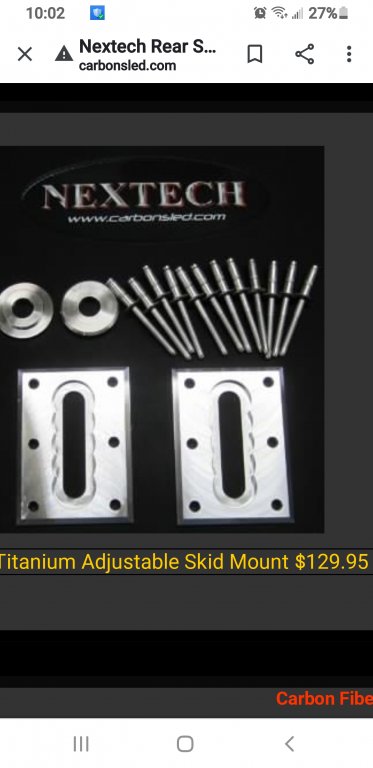

You could do bracket with 2 sets of holes or use adjustable front brackets terra alps also told me to mount mine closer to take weight off the front end. I have 2 ez ryde skids 155 and 159 and trying to install the 159 with no luck at this timeThey didn’t give me a diagram. I just wrote down what he told me on phone. The mounting location was about 7/8 further back but he said to move it fwd 7/8 to lighten the ski pressure. When I did the math the mounting location was really close except the distance from the top of the tunnel. The diagram you gave me shows it being down 8.2 but the Tera Alps guy said. 9.3/8. I’m open to ideas or I might just make the tunnel plates to have both holes.
MNytroXTX
I’ve seen those and it might be the way I go. How hard are they to tune after you get them in. I will mainly using it for trail riding with some off trail when it gets deep.View attachment 160170
You could do bracket with 2 sets of holes or use adjustable front brackets terra alps also told me to mount mine closer to take weight off the front end. I have 2 ez ryde skids 155 and 159 and trying to install the 159 with no luck at this time View attachment 160170

Not sure I am still trying to get mine installed if I get some dimensions or measurements for itI’ve seen those and it might be the way I go. How hard are they to tune after you get them in. I will mainly using it for trail riding with some off trail when it gets deep.
