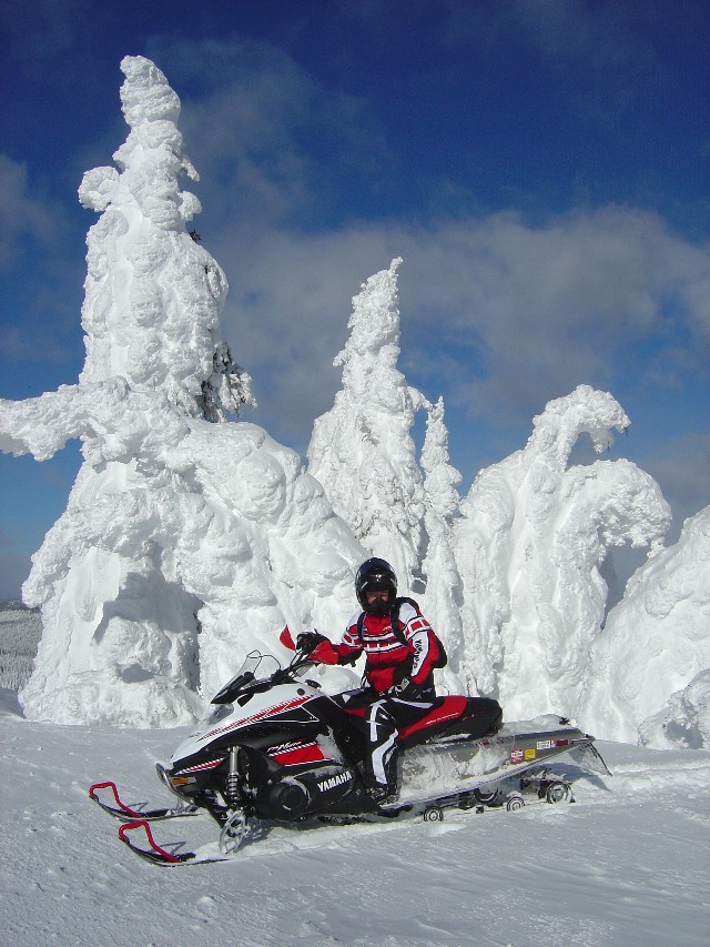

Put on 45 miles today and the MTX is going to be a real nice sled once a few things are changed. Pulls good for not having any miles on it but the track , stock suspension and the hand warmers got a go..
When I ran a Maverick track on my A/C 900 I loved it, but on MTX I never felt it hook up much at all. Just seemed to spin and spin. Could be the torque of the 4 stroke I guess. I have a Camo 2.25 extreme on the shop floor to be installed this week. Most of you know the stock skid is way to soft so a K-Mod rear skid valved for my fat a$$ is sitting next to the new Camo also. Why Yamaha put such crappy front shocks on such a nice sled is behond me and so I have a set of floats on order too.. The handwarmers did not get hot at all so I froze the heck my hands and I don't have a clue how to make them work like HAND WARMERS.??
They were on high all day long with nil heat. Seems like all the ride reports so far are close in
comparing.. A couple pics..
