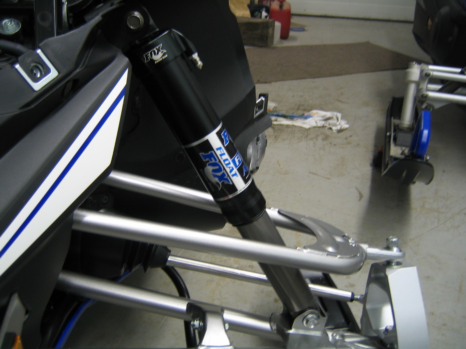

Sierraspirit
Fox Floats
Here are a couple of pics of the 03-05 RX-1 Aftermarket Fox Floats on a 08 FX Nytro. They fit perfectly and ride very nice. Like Tom RX-1 stated, they are the same length. So far I like them better than the clickers factory on the Standard FX Nytro.
